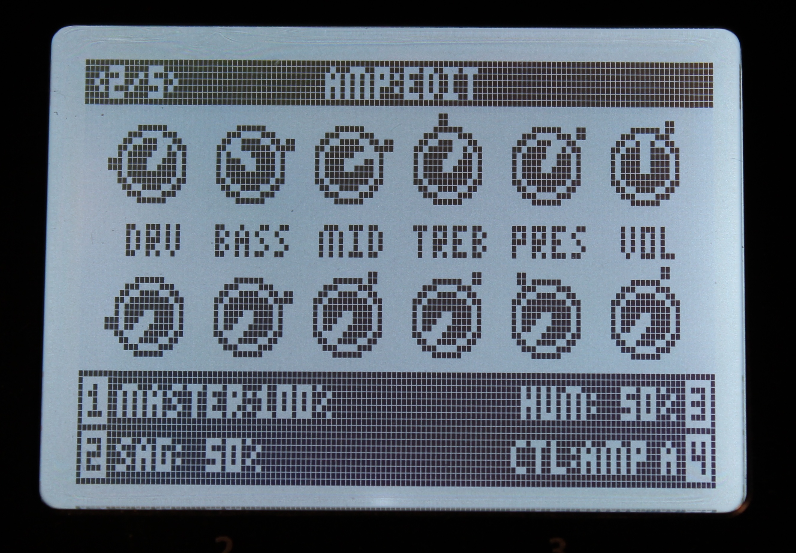

Create an amp in the amp block. To closer match what you’ll hear me do in a moment, choose the Plexi Lead 100 Bright amp, and leave all the cab and mic parameters at their default, as I did. You can see where the amp knobs are placed in the screenshot below.
Now, with your guitar plugged in and making noise, move the cursor to the amp block, and double-tap the ENTER button to see the deep parameters for the amp. Hit the right arrow on the navigation button twice to get to Page 2. You’ll see this:
Sag 50
Default Sag Settings
